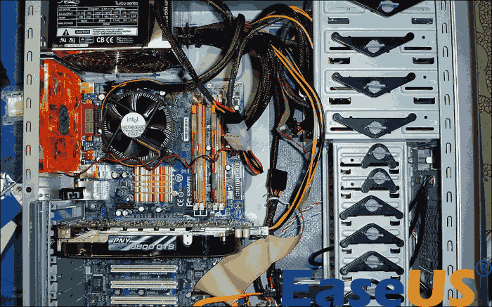

  1. Check hardware connection
If the issue is caused by loose hardware, you can try to remove the side panel and check that the components are correctly installed in their respective sockets if you're able to do so. You should also try to remove and then plug back components like the graphics card, RAM, heatsink, and motherboard cables.
If you can hear the computer running but see nothing on the monitor, it’s likely a display issue. Check if your monitor is damaged, if it's firmly attached to the computer, and if it is plugged into the correct input. If the monitor doesn't work right, it is broken. Replace it.
Besides, computers could also be interfered with by other devices. Unplug devices like webcams, external hard drives, and printers from your computer, then restart it with only the basic devices connected.

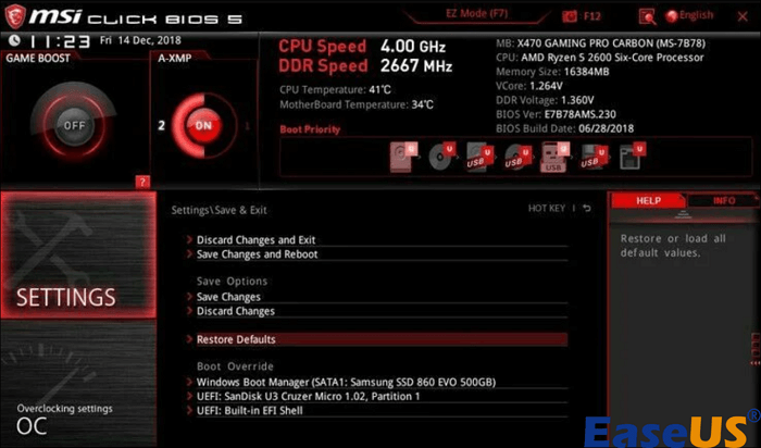

  1. Check the BIOS
If you see an error that tells you the computer can't find a bootable OS, it may mean the BIOS is incorrectly set to boot from the wrong drive. Or, your overclock settings are leading the computer to a blue screen immediately. Check your computer's user manual to find out the specific key to enter the BIOS when the POST screen appears.
After getting in the BIOS, set the computer to boot from your primary hard drive and disable the Fast Boot feature. You can also check if there are any other unusual settings that might lead to boot issues.
If you're still having difficulties accessing your operating system after checking and addressing the error messages, resetting BIOS to the default settings may be your best choice.
